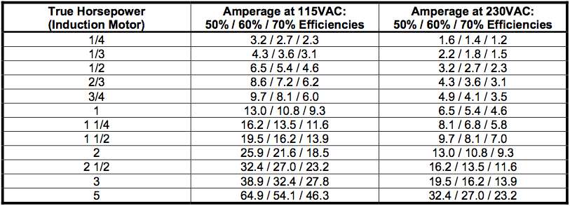

Ken, I think you may be thinking about power factor(which is needed to figure out your input wattage, and relates to the current and voltage phase relationship), service factor is a rating that tells you what percentage of the full load current the motor can run at continuously without damage(typical rating would be 1.15 or 115% of the FLA). Efficiency is another rating. That relates to power put in and power at the shaft. Most small motors have an efficiency rating close to 80%, larger motors tend to be higher. Of course not all X HP motors have the same torque curve, bearing quality, insulation quality, cooling ability and so forth. So depending on the usage one motor may provide you with much better effective performance.
For a motor to draw 14 amps @110 volts and rate at 2HP. It would need to be better than 90% efficient. This is not unheard of as standards for efficiency are being required to be higher. That would be a pretty optimistic sounding number for a reasonably inexpensive motor.

PostPosted: Sun Aug 19, 2007 6:53 pm
Posts: 2060
I found a good article on this subject.
http://
users.goldengate.net/~kbrady/motors.pdf
This chart (clipped from the article) is a good reference to keep on hand.
